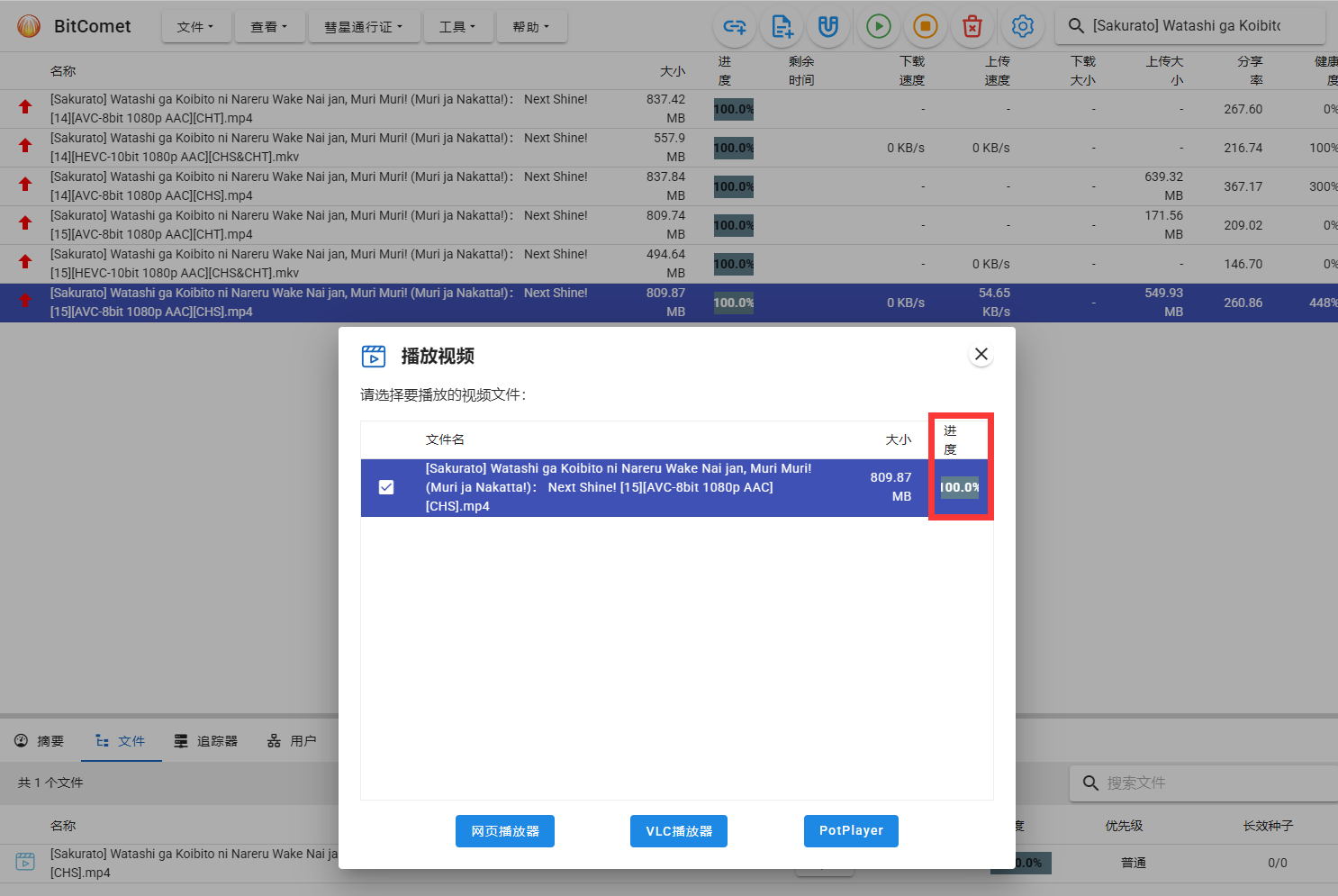

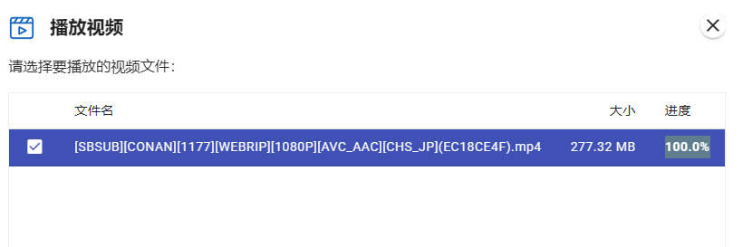

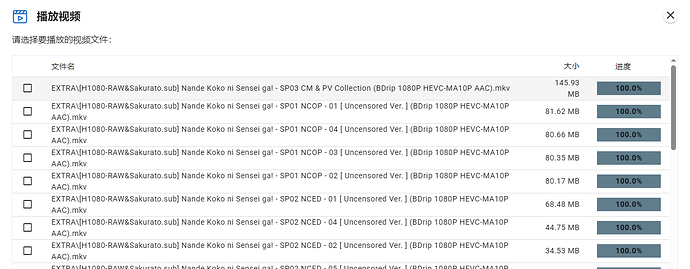

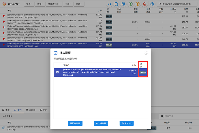

beta3 100%的1字显示不全,进度两个字是竖着的,大小的MB也跑到了第二行
上一版显示正常
感谢反馈,下一版已修复

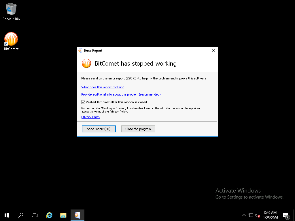

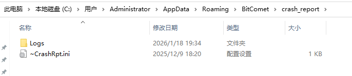

浏览器上复制磁力链接,然后客户端崩溃了,错误报告好像没发上去,看了下这个zip文件不见了

Server response body:450 Crash report disc quota for this project has exceeded.
Assuming legacy method of determining delivery status (from HTTP response body).
Failed (HTTP response body doesn't start with code 200).
Error sending HTTP request.
[sending_attempt]
Sending error report over SMTP is disabled (negative priority); skipping.
[sending_attempt]
Sending error report over SMAPI is disabled (negative priority); skipping.
[status_failed]
服务器上做个垃圾清理?自动删除2天之前的崩溃报告文件,这样客户端就不会发送失败了
rm -rf /home/crash_report/`date "+%Y-%m-%d" -d "-2day"`
感谢反馈,需要运行服务器上的清理脚本了

没修好,还是有问题,2位数MB正常,3位数或者 1010.95 MB 这种四位数的显示不正常

Windows Server 偶爾會當機
BC不适合伺服器用,要有心理准备
