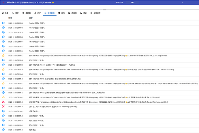

日志提示看起来是打开文件受限,Linux内核默认值是1024,尝试修改
ulimit -n 1048576
echo "* soft nofile 1048576" >> /etc/security/limits.conf
echo "* hard nofile 1048576" >> /etc/security/limits.conf
这个是linux的限制,解决方法参考:https://imnks.com/9169.html
