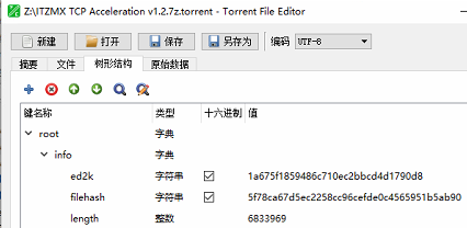

我查看了一个制作时勾选了长效和ed2k的种子,种子文件内多出了ed2k和filehash两项:
经验证,filehash字段与对应文件的sha1校验值一致。如果长效种子使用这个字段,那说明长效的实现是依赖sha1而非ed2k。(收回9楼的推测)

Info keys common to both single-file and multi-file modes:
  • “ed2k”: (optional) 128 bit eMule hash for each file of the torrent;
  • “filehash”: (optional) 160 bit LT-Seeding hash for each file of the torrent;
  • “piece length”: number of bytes in each piece (integer);
  • “pieces”: string consisting of the chaining together of all 20-byte SHA1 hash values, one per piece (byte string);
  • “private”: (optional) if the torrent is a Private Torrent (SecureTorrent), BitComet must only announce itself to the private tracker or to a single tracker at any time, if there are several trackers in the announce-list (integer, 0 or 1)1);
  • “publisher”: (optional) the name of the torrent creator, if do not allow to be changed (string);
  • “publisher-url”: (optional) the URL of the torrent creator if do not allow to be changed (string);
