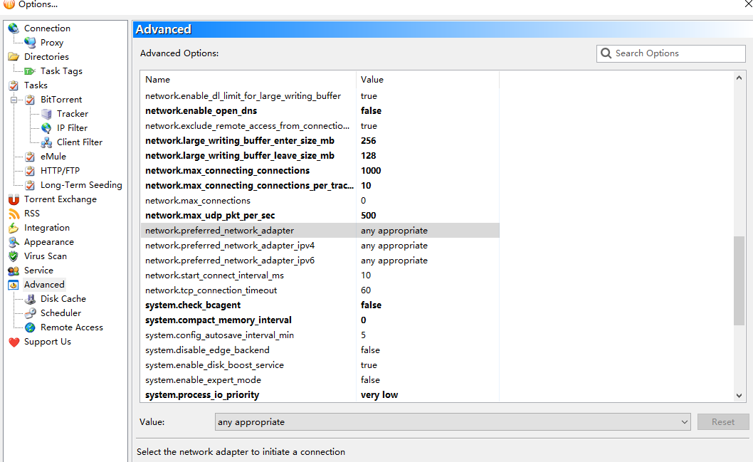

可以在 BitComet 中綁定 VPN 介面嗎? Qbit、BiglyBT 和 Transmission 用戶端都有這個選項,可以在 VPN 中斷時停止 BitTorrent 連線。我的母語不是中文,所以如果我寫得不正確,請見諒。
Yes, this option is called network. referred_network_adapter in the advanced settings
It can use BitTorrent traffic to transfer through a specified adapter, but I’m not sure if Bitcomet will try other available adapters when the VPN disconnects
Some VPN adapters may disappear after disconnection, in which case we need to bind an IP address instead of a network adapter
Use the following options to bind an IP address
network.preferred_network_adapter_ipv4
network.preferred_network_adapter_ipv6
