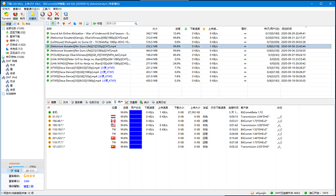

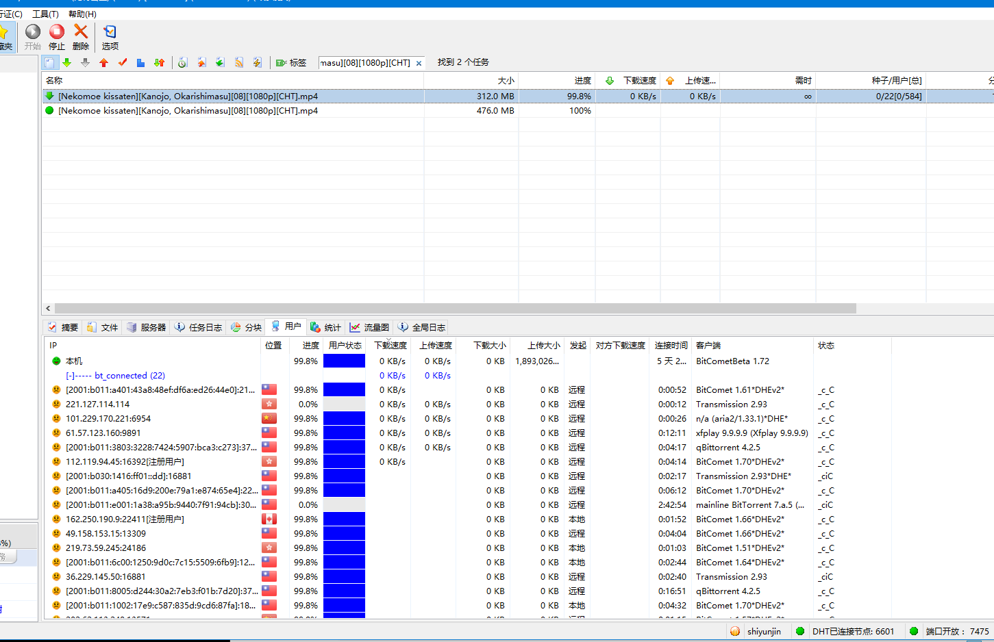

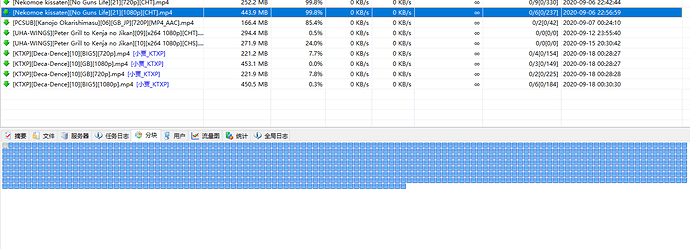

而且我连上卡在99.8%的客户端看起来都是bitcomet和transmission

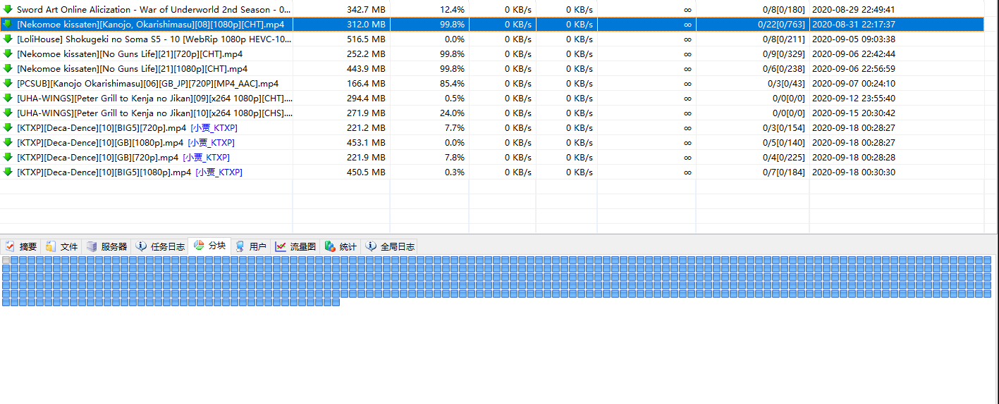

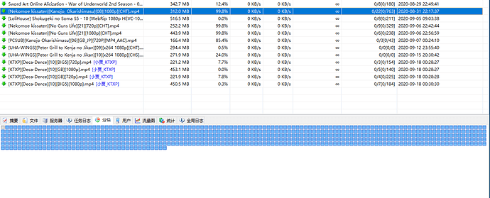

还有一个现象是卡住的任务有好几个都是第一个分块未下载
视频99.8%?

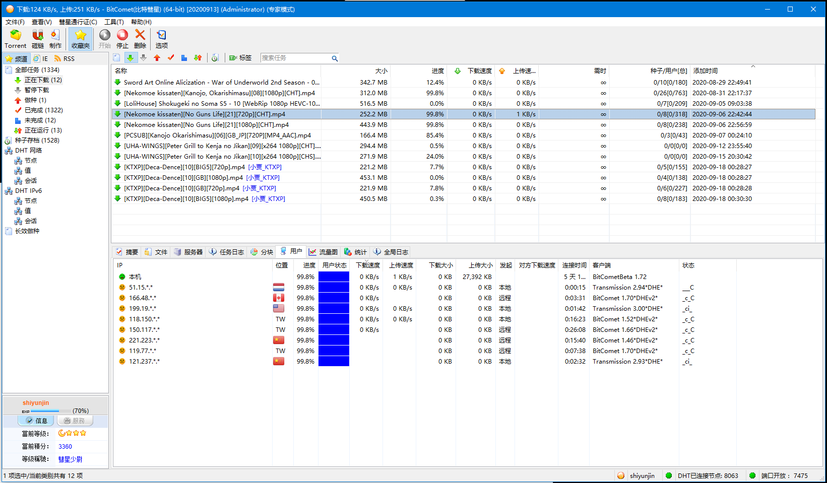

小文件 喵萌奶茶,悠什么哈字幕组,极影字幕组的,一般rss订阅2小时就停种了,公网做种得靠考虑循环迭代.
点击文件看看

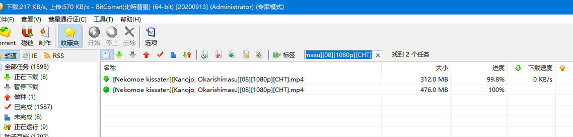

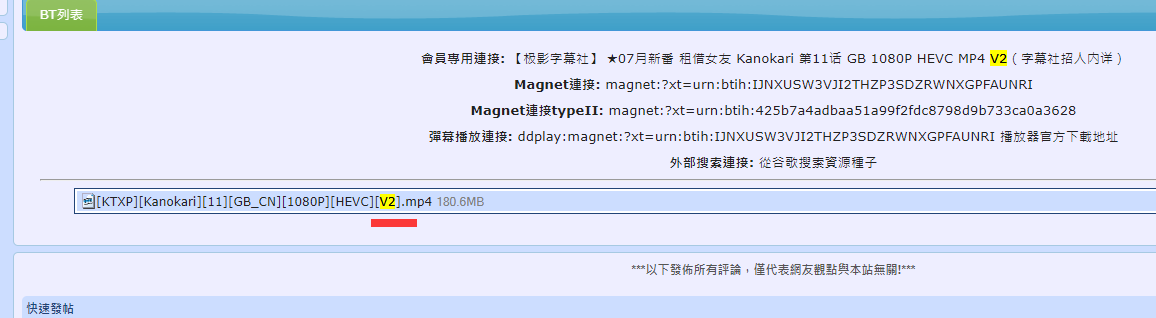

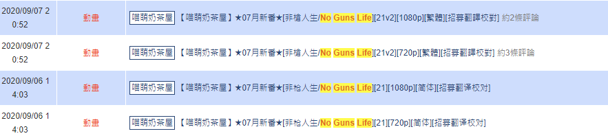

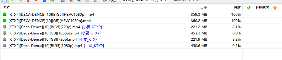

找到原因了,字幕组发了V2,种子下载的文件名是相同的
RSS下载的时候两个种子在写同一个文件,导致正常的那个种子下完文件也没有移动到对应目录,另一个因为没有人做种导致一直卡住举个栗子:
卡住的种子
magnet:?xt=urn:btih:SUCFCQO5BM6RNLDLBQLIICFEWFOCIIDH&dn=&tr=http%3A%2F%2F104.238.198.186%3A8000%2Fannounce&tr=udp%3A%2F%2F104.238.198.186%3A8000%2Fannounce&tr=http%3A%2F%2Ftracker.openbittorrent.com%3A80%2Fannounce&tr=udp%3A%2F%2Ftracker3.itzmx.com%3A6961%2Fannounce&tr=http%3A%2F%2Ftracker4.itzmx.com%3A2710%2Fannounce&tr=http%3A%2F%2Ftracker.publicbt.com%3A80%2Fannounce&tr=http%3A%2F%2Ftracker.prq.to%2Fannounce&tr=http%3A%2F%2Fopen.acgtracker.com%3A1096%2Fannounce&tr=https%3A%2F%2Ft-115.rhcloud.com%2Fonly_for_ylbud&tr=http%3A%2F%2Ftracker1.itzmx.com%3A8080%2Fannounce&tr=http%3A%2F%2Ftracker2.itzmx.com%3A6961%2Fannounce&tr=udp%3A%2F%2Ftracker1.itzmx.com%3A8080%2Fannounce&tr=udp%3A%2F%2Ftracker2.itzmx.com%3A6961%2Fannounce&tr=udp%3A%2F%2Ftracker3.itzmx.com%3A6961%2Fannounce&tr=udp%3A%2F%2Ftracker4.itzmx.com%3A2710%2Fannounce&tr=http%3A%2F%2Ftr.bangumi.moe%3A6969%2Fannounce
V2正常的种子:
magnet:?xt=urn:btih:KQIUXJ3N77S6N36W2AOTKEEC4OXLJTVZ&dn=&tr=http%3A%2F%2F104.238.198.186%3A8000%2Fannounce&tr=udp%3A%2F%2F104.238.198.186%3A8000%2Fannounce&tr=http%3A%2F%2Ftracker.openbittorrent.com%3A80%2Fannounce&tr=udp%3A%2F%2Ftracker3.itzmx.com%3A6961%2Fannounce&tr=http%3A%2F%2Ftracker4.itzmx.com%3A2710%2Fannounce&tr=http%3A%2F%2Ftracker.publicbt.com%3A80%2Fannounce&tr=http%3A%2F%2Ftracker.prq.to%2Fannounce&tr=http%3A%2F%2Fopen.acgtracker.com%3A1096%2Fannounce&tr=https%3A%2F%2Ft-115.rhcloud.com%2Fonly_for_ylbud&tr=http%3A%2F%2Ftracker1.itzmx.com%3A8080%2Fannounce&tr=http%3A%2F%2Ftracker2.itzmx.com%3A6961%2Fannounce&tr=udp%3A%2F%2Ftracker1.itzmx.com%3A8080%2Fannounce&tr=udp%3A%2F%2Ftracker2.itzmx.com%3A6961%2Fannounce&tr=udp%3A%2F%2Ftracker3.itzmx.com%3A6961%2Fannounce&tr=udp%3A%2F%2Ftracker4.itzmx.com%3A2710%2Fannounce&tr=http%3A%2F%2Ftr.bangumi.moe%3A6969%2Fannounce

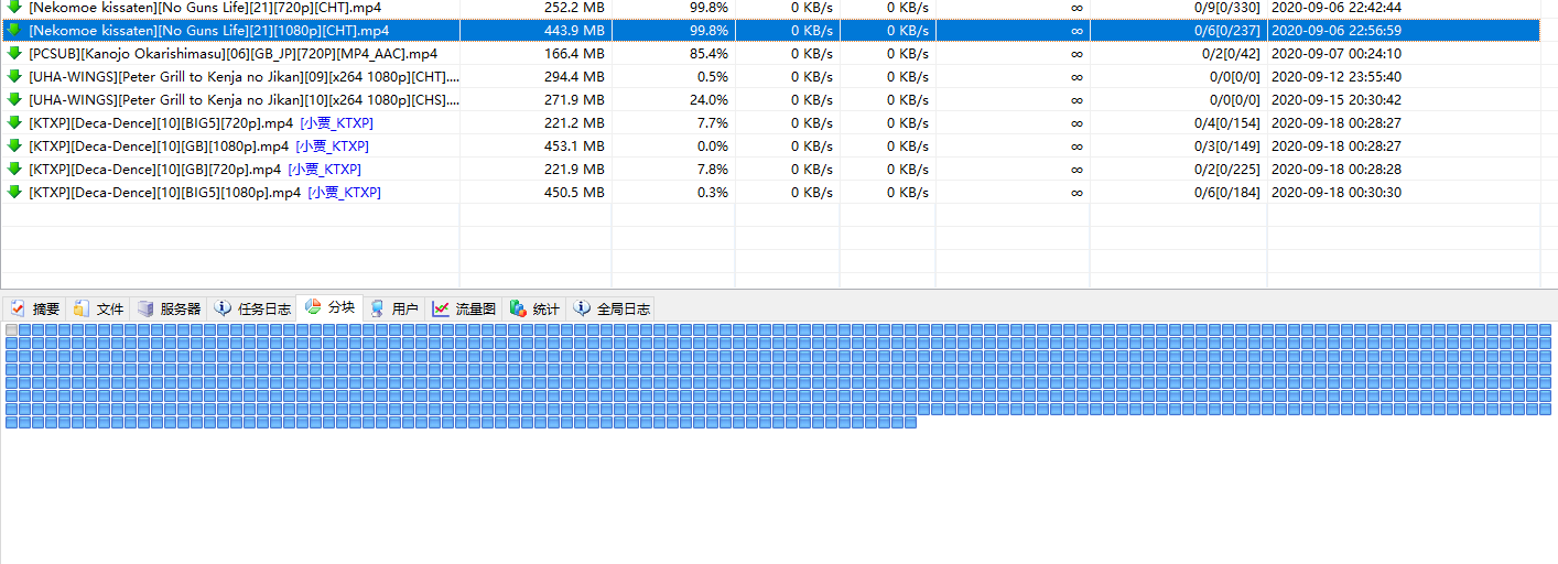

这两个文件名都是 [Nekomoe kissaten][No Guns Life][21][1080p][CHT].mp4

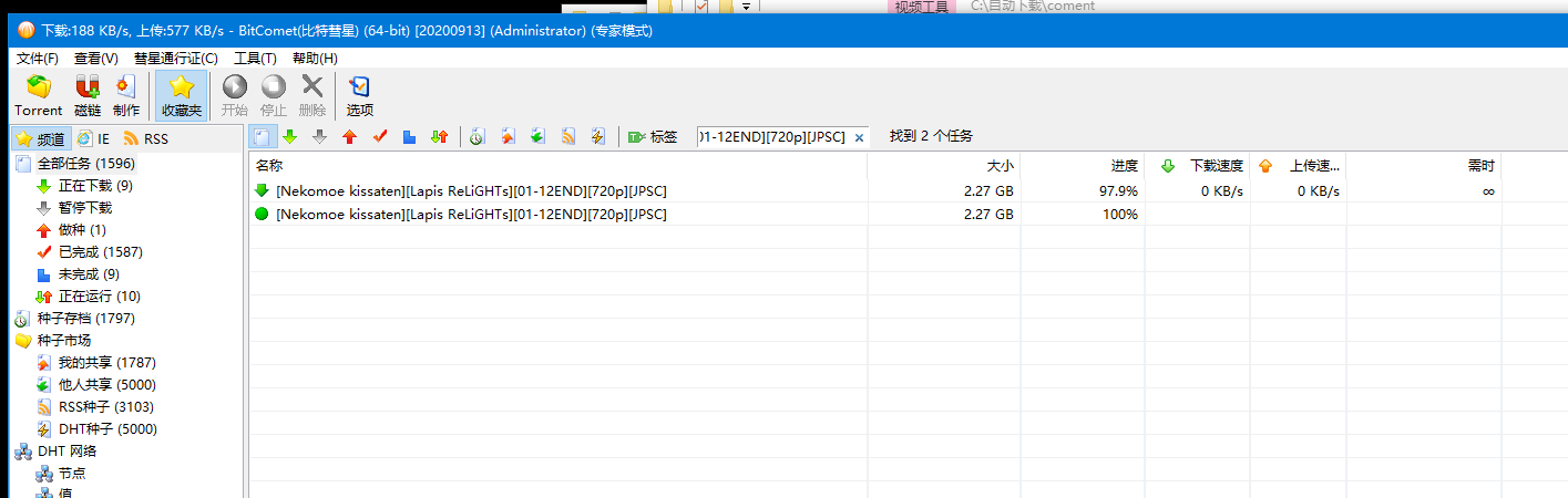

但是正常种子显示下载成功,但是文件却不见了
感觉这可能是个bug,如果需要还有一个720p的两个种子也有相同的问题,我可以粘一下
我之前用utorrent就不会有这个问题,下载中的数据会自动重命名防止多个任务写同一个文件,这个bug最大的问题是真正下完的那个任务的文件消失了,而只留下一个死种一直在显示下载,这可能也是我一开始说的卡住的任务链接到的用户大部分都是bitcomet的客户端

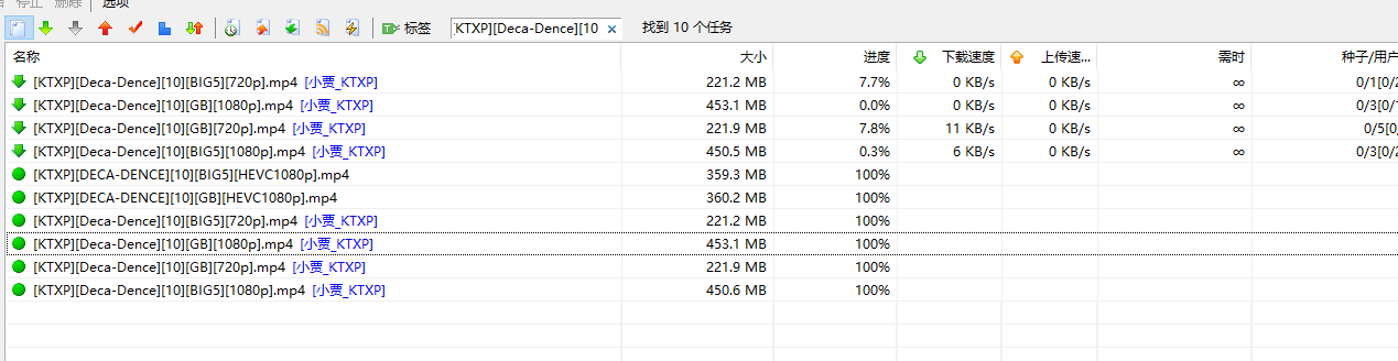

有复现步骤吗,最好有视频或者gif,我这新增加一个同名的种子,会提示是否检测完整性之类,默认会自动停止下载
rss订阅 动漫花园 ,只要种子中的文件名是同一个,理论上是必现的,比如说我上面贴出的那个,因为之前我已经删除过好几批死种了(细思极恐)以为和原来utorrent处理逻辑差不多,今天处理的时候才发现事情的严重性
rss的话得测一下试试,直接界面新增是没发现问题。有问题就好提交给官方修
界面直接添加我上面贴出的种子,可以保留正常下载的文件?这个我没试过,但是理论上逻辑不会不同啊
可能要先下死种的过程中,新增下载正常的种子,然后等正常的种子下载完,死种卡住
rss是后面版本最近才加的功能,难免有些不完善,一些因素可能没考虑到
或者有没有可能是我开了这个.bc!的功能导致的,都可以测试下
嗯,能找到复现步骤的话,都是好解决的问题,不好解决的问题都是没办法复现的。
