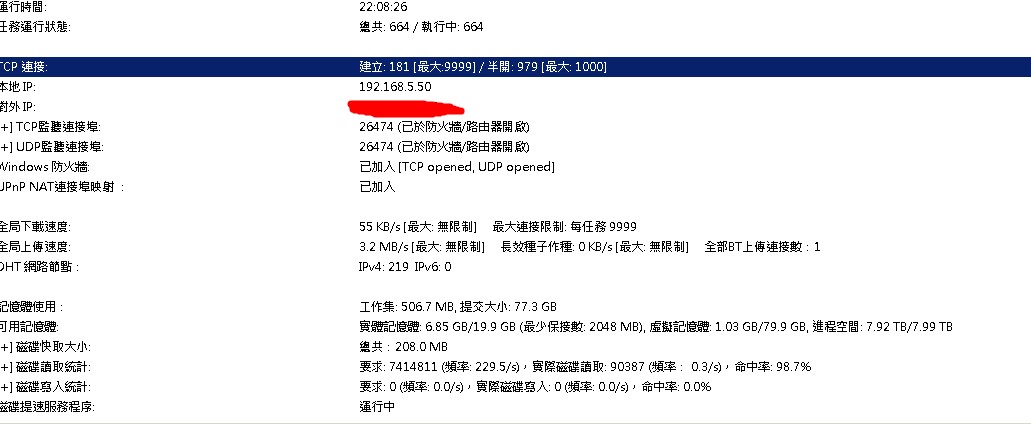

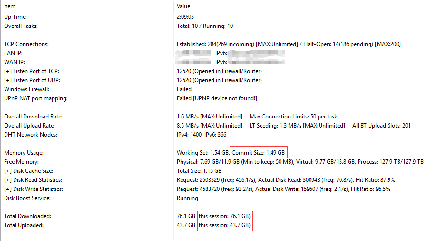

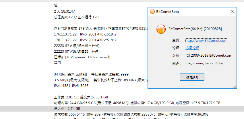

比特彗星1.56存在一处内存泄漏,占用内存超过40G!

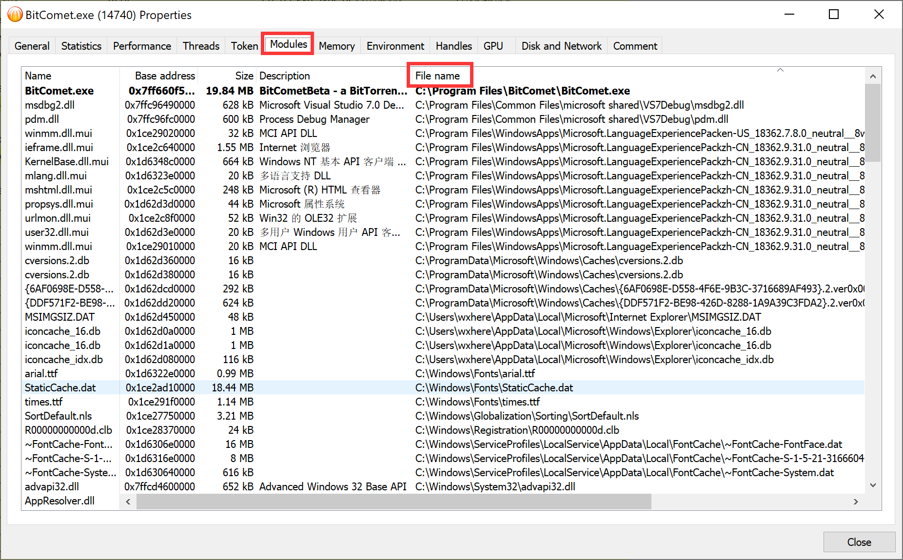

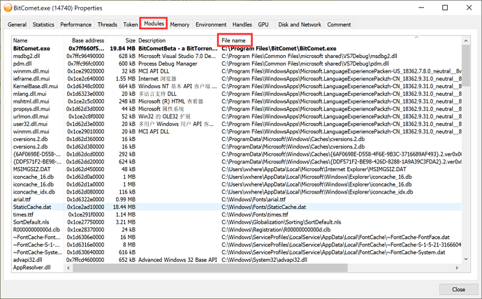

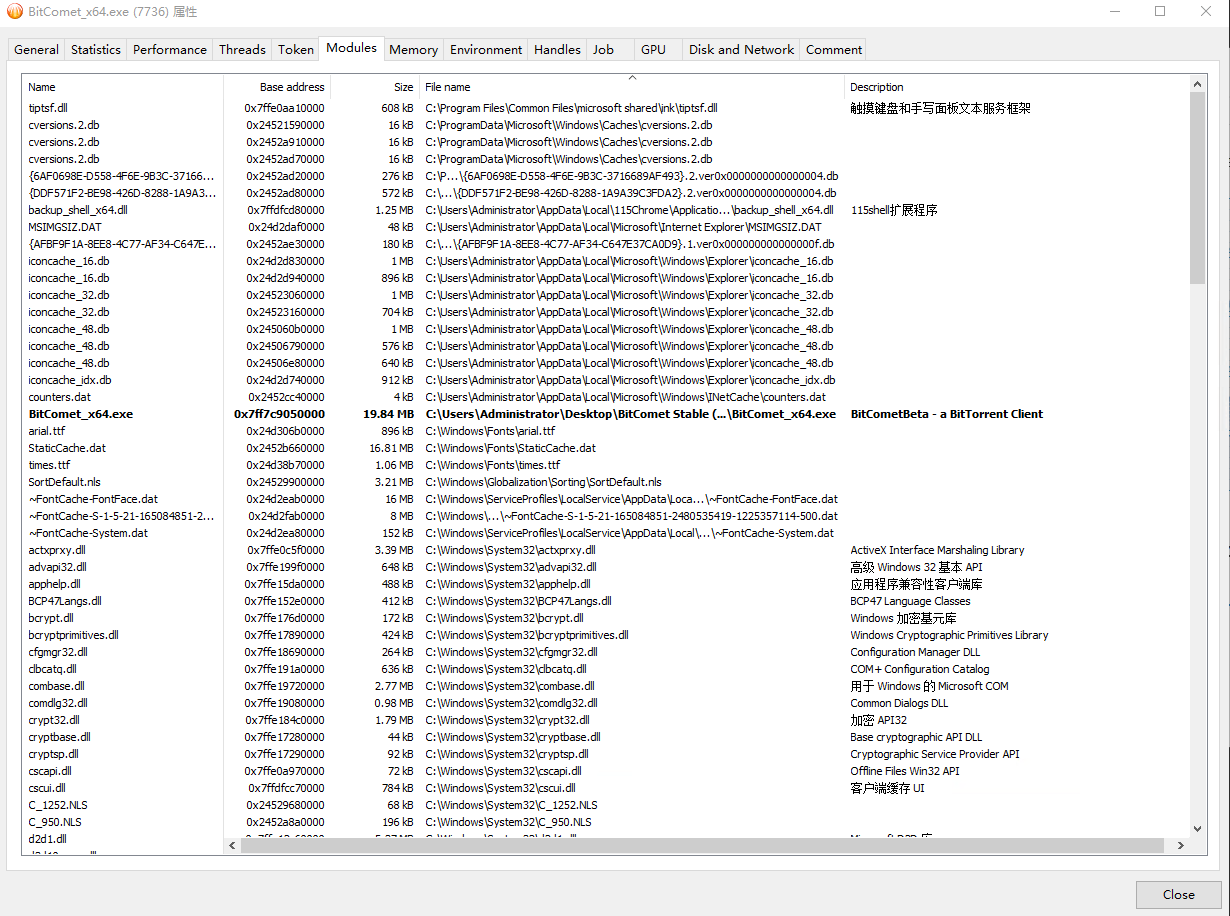

Process Hacker里双击进程,选择Modules页面。鼠标右键单击列表标题栏,选择choose columns。把File name列加入右边要显示的区域。
tiptsf.dll, 0x7ffe0aa10000, 608 kB, C:\Program Files\Common Files\microsoft shared\ink\tiptsf.dll, 触摸键盘和手写面板文本服务框架
cversions.2.db, 0x24521590000, 16 kB, C:\ProgramData\Microsoft\Windows\Caches\cversions.2.db,
cversions.2.db, 0x2452a910000, 16 kB, C:\ProgramData\Microsoft\Windows\Caches\cversions.2.db,
cversions.2.db, 0x2452ad70000, 16 kB, C:\ProgramData\Microsoft\Windows\Caches\cversions.2.db,
{6AF0698E-D558-4F6E-9B3C-3716689AF493}.2.ver0x0000000000000004.db, 0x2452ad20000, 276 kB, C:\ProgramData\Microsoft\Windows\Caches{6AF0698E-D558-4F6E-9B3C-3716689AF493}.2.ver0x0000000000000004.db,
{DDF571F2-BE98-426D-8288-1A9A39C3FDA2}.2.ver0x0000000000000004.db, 0x2452ad80000, 572 kB, C:\ProgramData\Microsoft\Windows\Caches{DDF571F2-BE98-426D-8288-1A9A39C3FDA2}.2.ver0x0000000000000004.db,

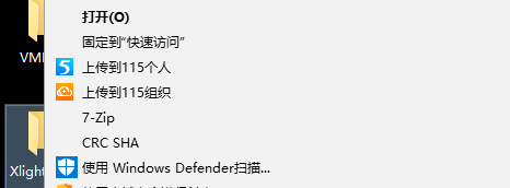

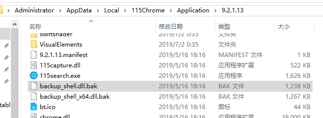

backup_shell_x64.dll, 0x7ffdfcd80000, 1.25 MB, C:\Users\Administrator\AppData\Local\115Chrome\Application\9.2.1.13\backup_shell_x64.dll, 115shell扩展程序
MSIMGSIZ.DAT, 0x24d2daf0000, 48 kB, C:\Users\Administrator\AppData\Local\Microsoft\Internet Explorer\MSIMGSIZ.DAT,
{AFBF9F1A-8EE8-4C77-AF34-C647E37CA0D9}.1.ver0x000000000000000f.db, 0x2452ae30000, 180 kB, C:\Users\Administrator\AppData\Local\Microsoft\Windows\Caches{AFBF9F1A-8EE8-4C77-AF34-C647E37CA0D9}.1.ver0x000000000000000f.db,
iconcache_16.db, 0x24d2d830000, 1 MB, C:\Users\Administrator\AppData\Local\Microsoft\Windows\Explorer\iconcache_16.db,
iconcache_16.db, 0x24d2d940000, 896 kB, C:\Users\Administrator\AppData\Local\Microsoft\Windows\Explorer\iconcache_16.db,
iconcache_32.db, 0x24523060000, 1 MB, C:\Users\Administrator\AppData\Local\Microsoft\Windows\Explorer\iconcache_32.db,
iconcache_32.db, 0x24523160000, 704 kB, C:\Users\Administrator\AppData\Local\Microsoft\Windows\Explorer\iconcache_32.db,
iconcache_48.db, 0x245060b0000, 1 MB, C:\Users\Administrator\AppData\Local\Microsoft\Windows\Explorer\iconcache_48.db,
iconcache_48.db, 0x24506790000, 576 kB, C:\Users\Administrator\AppData\Local\Microsoft\Windows\Explorer\iconcache_48.db,
iconcache_48.db, 0x24506e80000, 640 kB, C:\Users\Administrator\AppData\Local\Microsoft\Windows\Explorer\iconcache_48.db,
iconcache_idx.db, 0x24d2d740000, 912 kB, C:\Users\Administrator\AppData\Local\Microsoft\Windows\Explorer\iconcache_idx.db,
counters.dat, 0x2452cc40000, 4 kB, C:\Users\Administrator\AppData\Local\Microsoft\Windows\INetCache\counters.dat,
BitComet_x64.exe, 0x7ff7c9050000, 19.84 MB, C:\Users\Administrator\Desktop\BitComet Stable (build 1.58.7.6) 比特彗星全功能解锁豪华版\BitComet_x64.exe, BitCometBeta - a BitTorrent Client
arial.ttf, 0x24d306b0000, 896 kB, C:\Windows\Fonts\arial.ttf,
StaticCache.dat, 0x2452b660000, 16.81 MB, C:\Windows\Fonts\StaticCache.dat,
times.ttf, 0x24d38b70000, 1.06 MB, C:\Windows\Fonts\times.ttf,
SortDefault.nls, 0x24529900000, 3.21 MB, C:\Windows\Globalization\Sorting\SortDefault.nls,
~FontCache-FontFace.dat, 0x24d2eab0000, 16 MB, C:\Windows\ServiceProfiles\LocalService\AppData\Local\FontCache~FontCache-FontFace.dat,
~FontCache-S-1-5-21-165084851-2480535419-1225357114-500.dat, 0x24d2fab0000, 8 MB, C:\Windows\ServiceProfiles\LocalService\AppData\Local\FontCache~FontCache-S-1-5-21-165084851-2480535419-1225357114-500.dat,
~FontCache-System.dat, 0x24d2ea80000, 152 kB, C:\Windows\ServiceProfiles\LocalService\AppData\Local\FontCache~FontCache-System.dat,
actxprxy.dll, 0x7ffe0c5f0000, 3.39 MB, C:\Windows\System32\actxprxy.dll, ActiveX Interface Marshaling Library
advapi32.dll, 0x7ffe199f0000, 648 kB, C:\Windows\System32\advapi32.dll, 高级 Windows 32 基本 API
apphelp.dll, 0x7ffe15da0000, 488 kB, C:\Windows\System32\apphelp.dll, 应用程序兼容性客户端库
BCP47Langs.dll, 0x7ffe152e0000, 412 kB, C:\Windows\System32\BCP47Langs.dll, BCP47 Language Classes
bcrypt.dll, 0x7ffe176d0000, 172 kB, C:\Windows\System32\bcrypt.dll, Windows 加密基元库
bcryptprimitives.dll, 0x7ffe17890000, 424 kB, C:\Windows\System32\bcryptprimitives.dll, Windows Cryptographic Primitives Library
cfgmgr32.dll, 0x7ffe18690000, 264 kB, C:\Windows\System32\cfgmgr32.dll, Configuration Manager DLL
clbcatq.dll, 0x7ffe191a0000, 636 kB, C:\Windows\System32\clbcatq.dll, COM+ Configuration Catalog
combase.dll, 0x7ffe19720000, 2.77 MB, C:\Windows\System32\combase.dll, 用于 Windows 的 Microsoft COM
comdlg32.dll, 0x7ffe19080000, 0.98 MB, C:\Windows\System32\comdlg32.dll, Common Dialogs DLL
crypt32.dll, 0x7ffe184c0000, 1.79 MB, C:\Windows\System32\crypt32.dll, 加密 API32
cryptbase.dll, 0x7ffe17280000, 44 kB, C:\Windows\System32\cryptbase.dll, Base cryptographic API DLL
cryptsp.dll, 0x7ffe17290000, 92 kB, C:\Windows\System32\cryptsp.dll, Cryptographic Service Provider API
cscapi.dll, 0x7ffe0a970000, 72 kB, C:\Windows\System32\cscapi.dll, Offline Files Win32 API
cscui.dll, 0x7ffdfcc70000, 784 kB, C:\Windows\System32\cscui.dll, 客户端缓存 UI
C_1252.NLS, 0x24529680000, 68 kB, C:\Windows\System32\C_1252.NLS,
C_950.NLS, 0x2452a8a0000, 196 kB, C:\Windows\System32\C_950.NLS,
d2d1.dll, 0x7ffe12c60000, 5.37 MB, C:\Windows\System32\d2d1.dll, Microsoft D2D 库
d3d10warp.dll, 0x7ffe131c0000, 2.55 MB, C:\Windows\System32\d3d10warp.dll, Direct3D 10 Rasterizer
d3d11.dll, 0x7ffe13450000, 2.71 MB, C:\Windows\System32\d3d11.dll, Direct3D 11 Runtime
DataExchange.dll, 0x7ffe00780000, 292 kB, C:\Windows\System32\DataExchange.dll, Data exchange
dcomp.dll, 0x7ffe15830000, 1.32 MB, C:\Windows\System32\dcomp.dll, Microsoft DirectComposition Library
dhcpcsvc.dll, 0x7ffe11380000, 104 kB, C:\Windows\System32\dhcpcsvc.dll, DHCP 客户端服务
dhcpcsvc6.dll, 0x7ffe113a0000, 88 kB, C:\Windows\System32\dhcpcsvc6.dll, DHCPv6 客户端
dnsapi.dll, 0x7ffe16e50000, 648 kB, C:\Windows\System32\dnsapi.dll, DNS 客户端 API DLL
dui70.dll, 0x7ffdf9030000, 1.66 MB, C:\Windows\System32\dui70.dll, Windows DirectUI 引擎
duser.dll, 0x7ffdf9650000, 592 kB, C:\Windows\System32\duser.dll, Windows DirectUser Engine
dwmapi.dll, 0x7ffe15350000, 152 kB, C:\Windows\System32\dwmapi.dll, Microsoft 桌面窗口管理器 API
DWrite.dll, 0x7ffe117d0000, 2.41 MB, C:\Windows\System32\DWrite.dll, Microsoft DirectX 版式服务
dxgi.dll, 0x7ffe16790000, 636 kB, C:\Windows\System32\dxgi.dll, DirectX Graphics Infrastructure
edputil.dll, 0x7ffe0f670000, 264 kB, C:\Windows\System32\edputil.dll, EDP 实用程序
EhStorShell.dll, 0x7ffdfcd40000, 216 kB, C:\Windows\System32\EhStorShell.dll, Windows 增强的存储外壳扩展 DLL
imageres.dll.mui, 0x24506a10000, 4 kB, C:\Windows\System32\en-US\imageres.dll.mui, Windows Image Resource
ExplorerFrame.dll, 0x7ffdfeb40000, 4.52 MB, C:\Windows\System32\ExplorerFrame.dll, ExplorerFrame
FirewallAPI.dll, 0x7ffe16380000, 540 kB, C:\Windows\System32\FirewallAPI.dll, Windows 防火墙 API
fwbase.dll, 0x7ffe16190000, 172 kB, C:\Windows\System32\fwbase.dll, Firewall Base DLL
fwpolicyiomgr.dll, 0x7ffe0e9e0000, 220 kB, C:\Windows\System32\fwpolicyiomgr.dll, FwPolicyIoMgr DLL
FWPUCLNT.DLL, 0x7ffe10a90000, 424 kB, C:\Windows\System32\FWPUCLNT.DLL, FWP/IPsec 用户模式 API
gdi32.dll, 0x7ffe18930000, 208 kB, C:\Windows\System32\gdi32.dll, GDI Client DLL
gdi32full.dll, 0x7ffe17b20000, 1.5 MB, C:\Windows\System32\gdi32full.dll, GDI Client DLL
ieapfltr.dll, 0x7ffe0b6b0000, 1.59 MB, C:\Windows\System32\ieapfltr.dll, Microsoft SmartScreen Filter
ieframe.dll, 0x2452a390000, 64 kB, C:\Windows\System32\ieframe.dll, Internet 浏览器
ieframe.dll, 0x7ffdf62f0000, 12.57 MB, C:\Windows\System32\ieframe.dll, Internet 浏览器
iertutil.dll, 0x7ffe13a00000, 2.69 MB, C:\Windows\System32\iertutil.dll, Internet Explorer 的运行时实用程序
imageres.dll, 0x24d5cb80000, 25 MB, C:\Windows\System32\imageres.dll, Windows Image Resource
imm32.dll, 0x7ffe19240000, 184 kB, C:\Windows\System32\imm32.dll, Multi-User Windows IMM32 API Client DLL
IPHLPAPI.DLL, 0x7ffe16e10000, 224 kB, C:\Windows\System32\IPHLPAPI.DLL, IP 帮助程序 API
jscript9.dll, 0x7ffe0adf0000, 4.57 MB, C:\Windows\System32\jscript9.dll, Microsoft ® JScript
kernel.appcore.dll, 0x7ffe17800000, 60 kB, C:\Windows\System32\kernel.appcore.dll, AppModel API Host
kernel32.dll, 0x7ffe19600000, 688 kB, C:\Windows\System32\kernel32.dll, Windows NT 基本 API 客户端 DLL
KernelBase.dll, 0x7ffe17900000, 2.11 MB, C:\Windows\System32\KernelBase.dll, Windows NT 基本 API 客户端 DLL
linkinfo.dll, 0x7ffe0fbe0000, 64 kB, C:\Windows\System32\linkinfo.dll, Windows Volume Tracking
locale.nls, 0x24527d00000, 772 kB, C:\Windows\System32\locale.nls,
mlang.dll, 0x7ffdf62b0000, 252 kB, C:\Windows\System32\mlang.dll, 多语言支持 DLL
msasn1.dll, 0x7ffe17880000, 64 kB, C:\Windows\System32\msasn1.dll, ASN.1 Runtime APIs
msctf.dll, 0x7ffe18f20000, 1.36 MB, C:\Windows\System32\msctf.dll, MSCTF 服务器 DLL
msctfuimanager.dll, 0x7ffe012c0000, 884 kB, C:\Windows\System32\msctfuimanager.dll, Microsoft UIManager DLL
mshtml.dll, 0x7ffdf4c00000, 22.68 MB, C:\Windows\System32\mshtml.dll, Microsoft ® HTML 查看器
msimg32.dll, 0x7ffe086b0000, 28 kB, C:\Windows\System32\msimg32.dll, GDIEXT Client DLL
msimtf.dll, 0x7ffe0f250000, 64 kB, C:\Windows\System32\msimtf.dll, 活动 IMM 服务器 DLL
mssprxy.dll, 0x7ffe02ef0000, 140 kB, C:\Windows\System32\mssprxy.dll, Microsoft Search Proxy
msvcp110_win.dll, 0x7ffe161c0000, 580 kB, C:\Windows\System32\msvcp110_win.dll, Microsoft® STL110 C++ Runtime Library
msvcp_win.dll, 0x7ffe18790000, 624 kB, C:\Windows\System32\msvcp_win.dll, Microsoft® C Runtime Library
msvcrt.dll, 0x7ffe19bf0000, 632 kB, C:\Windows\System32\msvcrt.dll, Windows NT CRT DLL
mswsock.dll, 0x7ffe170d0000, 368 kB, C:\Windows\System32\mswsock.dll, Microsoft Windows Sockets 2.0 服务提供程序
netapi32.dll, 0x7ffe0f650000, 96 kB, C:\Windows\System32\netapi32.dll, Net Win32 API DLL
netutils.dll, 0x7ffe16f00000, 52 kB, C:\Windows\System32\netutils.dll, Net Win32 API Helpers DLL
networkexplorer.dll, 0x7ffdfcec0000, 1.15 MB, C:\Windows\System32\networkexplorer.dll, 网络浏览器
nsi.dll, 0x7ffe19180000, 32 kB, C:\Windows\System32\nsi.dll, NSI User-mode interface DLL
ntdll.dll, 0x7ffe1b3a0000, 1.81 MB, C:\Windows\System32\ntdll.dll, NT 层 DLL
ntmarta.dll, 0x7ffe169c0000, 200 kB, C:\Windows\System32\ntmarta.dll, Windows NT MARTA 提供程序
ntshrui.dll, 0x7ffe010a0000, 840 kB, C:\Windows\System32\ntshrui.dll, 用于共享的外壳扩展
ole32.dll, 0x7ffe194c0000, 1.22 MB, C:\Windows\System32\ole32.dll, 用于 Windows 的 Microsoft OLE
oleacc.dll, 0x7ffe00830000, 404 kB, C:\Windows\System32\oleacc.dll, Active Accessibility Core Component
oleaccrc.dll, 0x245215c0000, 8 kB, C:\Windows\System32\oleaccrc.dll, Active Accessibility Resource DLL
oleaut32.dll, 0x7ffe18970000, 768 kB, C:\Windows\System32\oleaut32.dll, OLEAUT32.DLL
OnDemandConnRouteHelper.dll, 0x7ffe11100000, 84 kB, C:\Windows\System32\OnDemandConnRouteHelper.dll, On Demand Connctiond Route Helper
policymanager.dll, 0x7ffe0de50000, 268 kB, C:\Windows\System32\policymanager.dll, Policy Manager DLL
powrprof.dll, 0x7ffe17830000, 304 kB, C:\Windows\System32\powrprof.dll, 电源配置文件帮助程序 DLL
profapi.dll, 0x7ffe17810000, 80 kB, C:\Windows\System32\profapi.dll, User Profile Basic API
propsys.dll, 0x7ffe11a60000, 1.52 MB, C:\Windows\System32\propsys.dll, Microsoft 属性系统
psapi.dll, 0x7ffe19190000, 32 kB, C:\Windows\System32\psapi.dll, Process Status Helper
rasadhlp.dll, 0x7ffe109a0000, 40 kB, C:\Windows\System32\rasadhlp.dll, Remote Access AutoDial Helper
rpcrt4.dll, 0x7ffe19ac0000, 1.13 MB, C:\Windows\System32\rpcrt4.dll, 远程过程调用运行时
rsaenh.dll, 0x7ffe16c90000, 204 kB, C:\Windows\System32\rsaenh.dll, Microsoft Enhanced Cryptographic Provider
samcli.dll, 0x7ffe126a0000, 100 kB, C:\Windows\System32\samcli.dll, Security Accounts Manager Client DLL
samlib.dll, 0x7ffe0d1a0000, 140 kB, C:\Windows\System32\samlib.dll, SAM Library DLL
sechost.dll, 0x7ffe19c90000, 356 kB, C:\Windows\System32\sechost.dll, Host for SCM/SDDL/LSA Lookup APIs
secur32.dll, 0x7ffe11e50000, 48 kB, C:\Windows\System32\secur32.dll, Security Support Provider Interface
setupapi.dll, 0x7ffe18a30000, 4.16 MB, C:\Windows\System32\setupapi.dll, Windows 安装程序 API
SHCore.dll, 0x7ffe183b0000, 676 kB, C:\Windows\System32\SHCore.dll, SHCORE
shdocvw.dll, 0x7ffdf9f00000, 260 kB, C:\Windows\System32\shdocvw.dll, Shell Doc 对象和控件库
shell32.dll, 0x7ffe19cf0000, 21.02 MB, C:\Windows\System32\shell32.dll, Windows Shell 公用 DLL
shlwapi.dll, 0x7ffe18e60000, 328 kB, C:\Windows\System32\shlwapi.dll, 外壳简易实用工具库
srpapi.dll, 0x7ffe0b850000, 156 kB, C:\Windows\System32\srpapi.dll, SRP API Dll

版本是最新的beta3
backup_shell_x64.dll 115shell扩展程序 我这边是没有的。。。
image 115浏览器?
这浏览器我几个月没开过了。。
这个DLL功能应该是右键菜单
应该是的,它修改了注册表,会在彗星启动时自动注入BitComet进程。可以把 C:\Users\Administrator\AppData\Local\115Chrome\Application\9.2.1.13\backup_shell_x64.dll 文件改个名字再启动彗星试试。不过内存泄露可能和它关系不大。
我试试看。
明天在看看结果
我也继续挂机试试看,目前还正常
可能你任务加少了,多加点看看。
好的,我再加一点任务
http://www.kisssub.org/ 比如一些资源发布站,首页加一页看看
好的,我试试看
任务加到600左右 效果很更明显 20G内存也最多坚持一天就爆内存 自动退出了
挂机不到1天 664个任务 提交大小竟然到了77.3G
谢谢反馈,继续测试中。加这么多任务可真不容易。。。
知道rss的好了吧,,,而且这网站有脚本功能,直接可以首页全选批量复制磁力,还是方便的
image 确实不是115浏览器的问题,dll已经看到没注入,内存依旧这样泄漏
